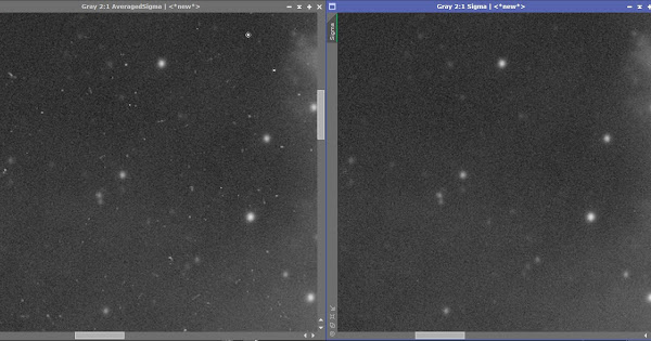

Btw, I had a run with an image set of 10 images. My default choice for image rejection then is Averaged Sigma. Maybe it is my ImageIntegration settings (I use defaults), but it did not really do any rejection. I tried all other rejections from Percentile Clip to EDS and they all did a good job on rejecting bad problems. With so many choices available I do not really need to use Averaged Sigma but I found it weird. I have not done more testing like trying it manually.
I repeated the problem with Averaged Sigma rejection just by loading images to the ImageIntegration process. For comparison, I have also a version with Sigma rejection and it worked fine.
I was otherwise using default values for ImageIntegration. Do you know if there some special options for Averaged Sigma that should be used? Other rejections worked fine with defaults.
Here is a link to the image where it easy to see the problem:
Google Photos
do you have the dataset available? juan always wants to see the data when trying to reproduce problems. i’m not sure i’ve ever used that rejection method so i don’t know offhand if special care is needed, but in general with my own data i find that even with windsorized sigma clipping i usually have to adjust the sliders to get proper rejection.
Yes, I have the files. They are registered files. Data is from Telescope Live but I assume it is ok to share as I am sharing only Halpha files. If needed I can share original FITS files.
well, lowering the high sigma to even 2.8 produces reasonable rejection on that dataset. IMO this is normal - all these algorithms are different and there’s probably no way to come up with defaults that always work right. i guess the most flexible thing to do is to expose the high sigma control to the user… i have seen this problem on some number of projects i’ve worked on with AI.js but never really dug into it. i don’t see any user control over rejection algorithm or rejection controls but i might not be up-to-date.
Thanks for checking it out! It makes sense what you said, it is probably impossible that defaults would work well in all cases.
I do have an option for rejection algorithm in section “Processing settings … integration …”. The last collapsed section, if you have an older version. I think I will add some configuration for different options. I already have too many options, so I guess a few more does not hurt :slight_smile:
