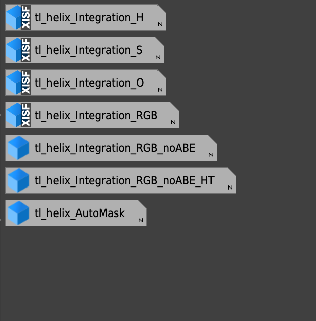

well the icon does exist and seems to be a product of the script, see screenshot. this is from SHO processing of some telescope.live images:
interestingly the icon is broken even before the script tries to close it. so something is weird here… as far as i know this is a window that the script has always created for me, unless i have something configured wrong.

this seems to have something to do with AutoContinue… maybe this is wrong usage, but what i have been doing is set a prefix and output directory, then loading a TL HSO dataset and first running with an HSO mapping. i then quit the script and start it again, and this time select a different narrowband mapping, like Helix HOO, then click AutoContinue.
i can see that the script is deiconifying tl_helix_Integration_RGB when AutoContinue is clicked. i’m wondering if it’s incorrectly trying to use that RGB image for something - my assumption is that because the narrowband mapping is different, a new RGB file must be created (and indeed it is, after AutoContinue has run, i see tl_helix_Integration_RGB1 which has the different mapping.) on the other hand, how would the script know that the mapping has changed and thus it needs to make a new RGB?
it’s at this point that the PI interface is messed up. the icon for tl_helix_Integration_RGB will not deiconify, but if i go into the view explorer and double click the image, it opens. if i then iconify it, there’s a 2nd icon for that image. either icon when double-clicked opens the image, and if i close the image then the other icon causes segfaults on the console when i interact with it.
can you reproduce this? am i doing AutoContinue wrong?
i guess i am doing this wrong based on the tooltips. i thought it was OK because the script does produce the correct new RGB mapping after running AC. but it looks like along the way something goes wrong with the original RGB image.
Thanks, this was a good catch. I was able to reproduce the problem with your description.
The problem happened when using AutoContinue with narrowband images and “window_prefix + Integration_RGB” window exists. AutoContinue did not detect the existing window and continued processing images. PixInsight then generated a “window_prefix + Integration_RGB1” name and this caused problems with the script window and icon management. The end result was a broken icon that cannot be deleted and I guess sometimes accessing the icon crashes PixInsight. I cannot fully explain why or how the icon is broken, though.
I added some checks for existing windows before starting the processing. I also added checks that when we rename or create windows they have a correct name. This will stop processing and may happen pretty late in the process but hopefully those early checks should cover most cases.
