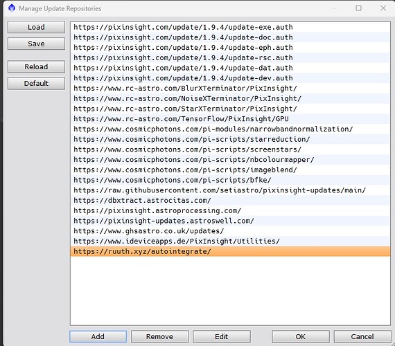

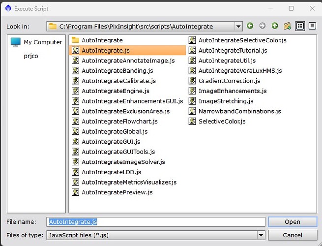

I have removed AutoIntegrate PixInsight repository from registry. Closed down and reloaded. Put it back into the registry. Ran update. It is being updated and it isn’t in Scripts.. The only way to run it is to use Execute Script and go to parent directory.
