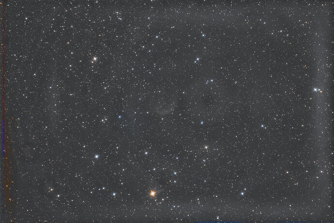

The jpg file attached has the stars with normal color but the Shrimp Nebula is gone.

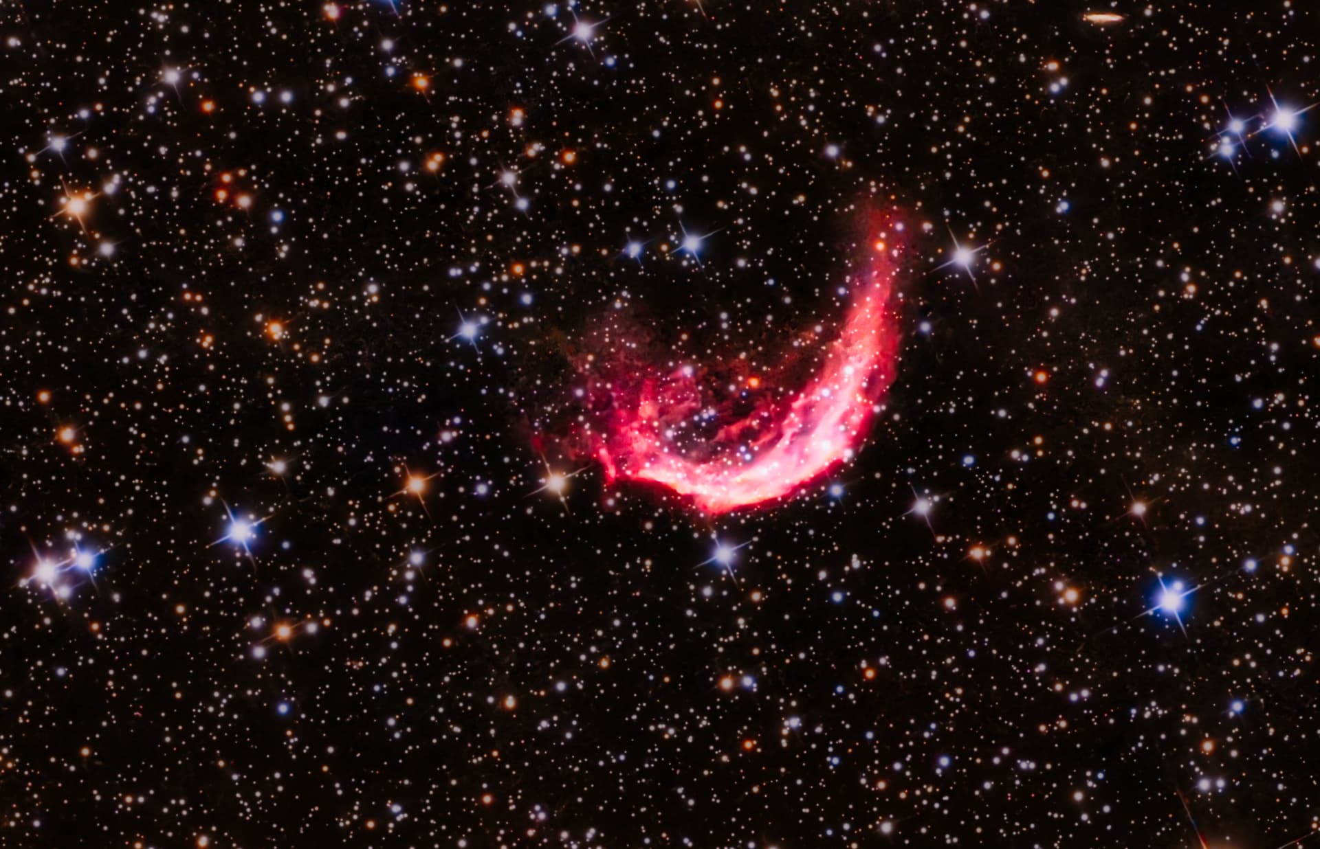

The second jpg is that from the first run of Autoexecute script before the update. This was post processed and has the colors more saturated and is cropped but as you can see, the nebula is colored and as clear as I could get with 8 hours and near full moon.

I wonder if it could be different stretching used. I actually changed the target types from [ ‘Default’, ‘Galaxy’, ‘Nebula’ ] to [ ‘Default’, ‘Galaxy’, ‘Small bright nebula’, ‘Large nebula’, ‘Star cluster’ ]. I wonder if a non-listed type would pick a wrong sterching. I kind of forgot to check that it does not cause problems.
Regards.
This problem seem to related to the new target list selection. The new list is ‘Default’, ‘Galaxy’, ‘Small bright nebula’, ‘Large nebula’ and ‘Star cluster’. The problem is that ‘Small bright nebula’ selection was processed with Masked stretch which was an incorrect choice for many cases.
In the next version I will revert the list to ‘Default’, ‘Galaxy’, ‘Nebula’ and ‘Star cluster’. Both ‘Small bright nebula’ and ‘Large nebula’ will be mapped to ‘Nebula’. As a general rule it is always useful to try different streching options to get the best results.
